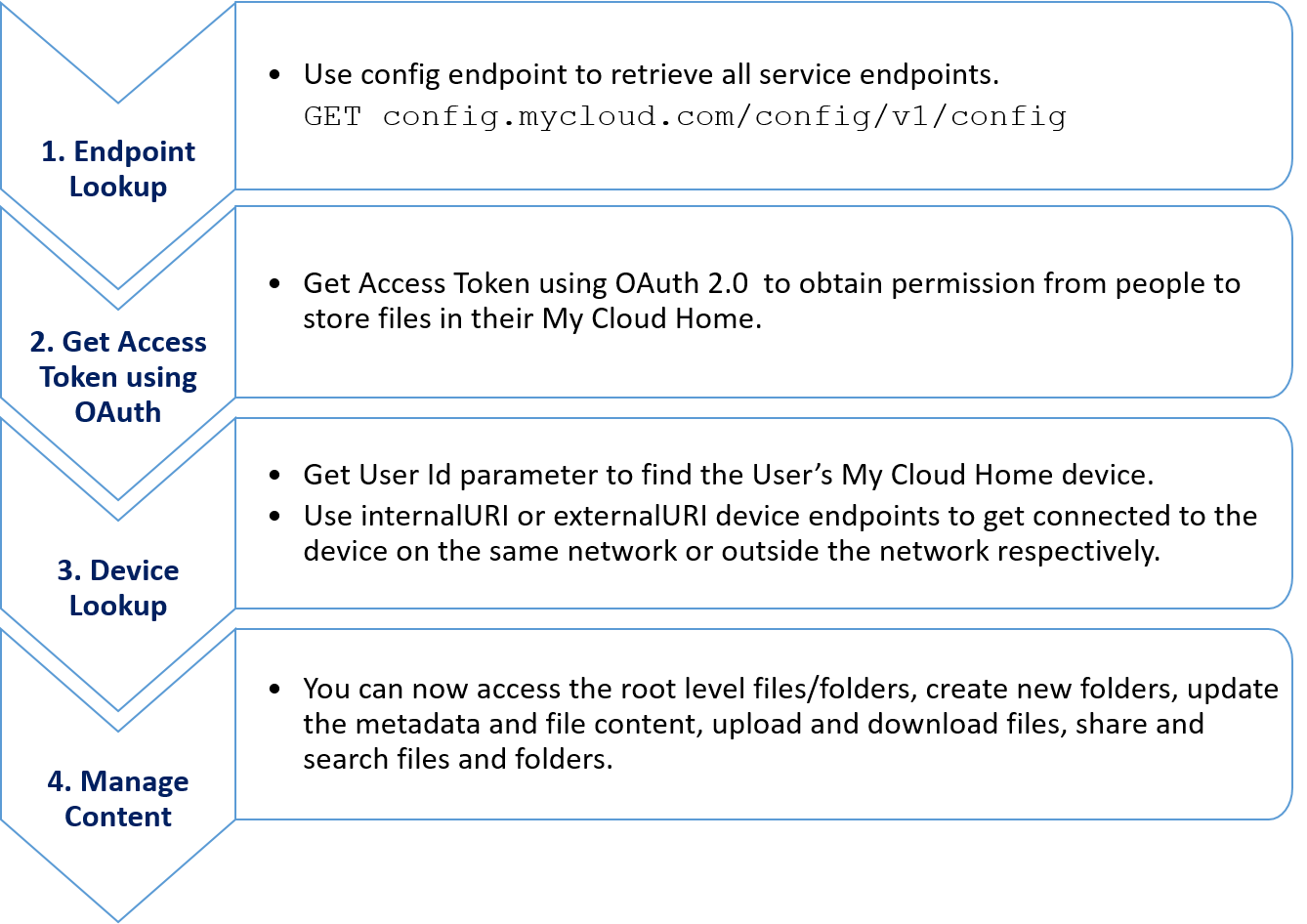

Before you start using My Cloud Home API, you need to 1) register for a free Developer Portal account and 2) register your app. You will receive your app developer credentials (Unique Client ID/Secret code) for your application.
On receiving your credentials, you can follow this end-to-end development scenario to create your app.
Apps primarily talk directly to the My Cloud Home device to access content. However, applications need to talk to My Cloud Home cloud services for authentication, sharing, device lookup, etc.
My Cloud Home application requires calling config endpoint (config.mycloud.com/config/v1/config) to retrieve all service endpoints. For example, whenever an application wants to connect to the My Cloud Home Device, the device service endpoints will give the routing information to reach the device. The API documentation would provide information on which service endpoints to use for each API.
My Cloud Home configuration API returns the current configuration URLs for the My Cloud Home services. My Cloud Home recommends applications to use the configuration API before using any API.
Refer to the Get Configuration page for details on using the Configuration API.
Applications should check cloud endpoints periodically to get updated device endpoint, as it changes based on device location and other external factors like the network.

My Cloud Home uses OAuth 2.0 for authentication. All APIs should carry an authorization token, which is a credential that identifies the user and application to the My Cloud Home system. Apps must provide access token through an HTTP header. The Bearer token included in the Authorization header identifies the user and his/her permissions to access the content.
Authorization: Bearer <id_token>
The application must use the “service.auth0.url” endpoint retrieved in Endpoint Lookup for making authentication API calls.
Refer to the Authentication page for details on getting access token.
Tokens issued by My Cloud Home OAuth server are valid for a predefined time. You can ask for 'offline_access' scope and obtain a 'refresh_token' while doing the initial OAuth flow. The application can save the refresh token and request tokens using the saved 'refresh_token' when the token expires.
Device Lookup refers to finding the My Cloud Home device attached to the user’s My Cloud Home account. In a typical flow, a user signs-in to https://home.mycloud.com/ and looks for an associated My Cloud Home device. When the device is located, the direct route to the device can be obtained. All the file management API actions are made directly to the device.
Using access token retrieved in the above step, you can use Device Lookup APIs to find information about the user’s My Cloud Home device. Refer to the Device Information page for details on APIs used for device lookup.
